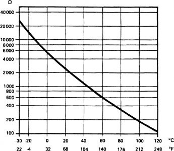

Hello NYArtist Fan relay, thermostat, and coolant sensor must be checked One way to check the thermostat is to start the engine and feel the upper radiator hose (or use an infrared noncontact thermometer to read its temperature). The hose should not feel uncomfortably hot until the engine has warmed-up and the thermostat opens. If the hose does not get hot, it means the thermostat is not opening. The best way to check the relay is to find one in the engine compartment and switch it with the suspected one, making sure there is power to it. if not, wiring from the relay to the motronic module must be checked, if wiring are good, driver circuit will be suspected. Coolant sensor can be tested using an ohmmeter and check the sensors resistance based on the temperature of the engine.(here is the chart)
https://images.2carpros.com/forum/automotive_pictures/46384_0900c1528008c698_1.jpg
