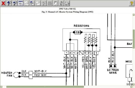

The AC does not work, so I had it checked out by the import mechanics. Because the multi-position blower switch only works on 1 speed they recommended starting with a blower resistor. Everything else works: AC compressor, holds coolant, but the switch just won't turn the compressor on. I purchased the blower resistor, but need to know where it is located on this Volvo. Also where is the associated wiring harness?

The AC/Heater blower motor resistor is located on right side of dash behind the glove box- also see below-
https://images.2carpros.com/forum/automotive_pictures/12900_resistor_5.jpg

Okay I found the blower motor resistor and changed it out. If you remove the glovebox first it is very easy to see the resistor. So now the blower motor has all 5 speeds but the AC compressor still will not turn on. The mechanic said the compressor works and the unit holds coolant. Any additional trouble shooting direction would be appreciated.
