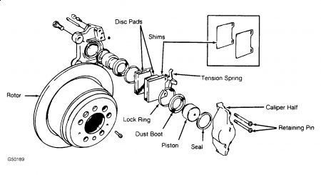

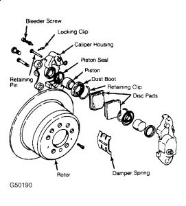

i got 1 brake pad on my sons car that is worn down.the right rear outside pad.i replaced both rear rotors and pads last year.did i do something wrong?or did something happen afterwards?i have been changing brakes on my own cars since 1984,but this is the first non-american car that i worked on.

Hi When outside pad on fixed caliper system wears quickly. piston sticking so caliper replacement or rebuild is needed. see diagrams for ATE and Girling
