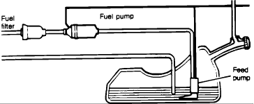

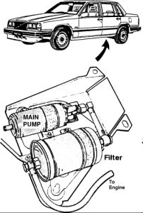

i want to replace my fuel pump but i don't know where it is

It actually has 2 pumps. The feeder pump is inside the fuel tank.
The pressure fuel pump is mounted under the left side of the frame, next to the fuel filter.

You got two-one outside and the other in the fuel tank-see below
https://images.2carpros.com/forum/automotive_pictures/12900_fuel_pump_34.jpg
https://images.2carpros.com/forum/automotive_pictures/12900_fp_13.gif
