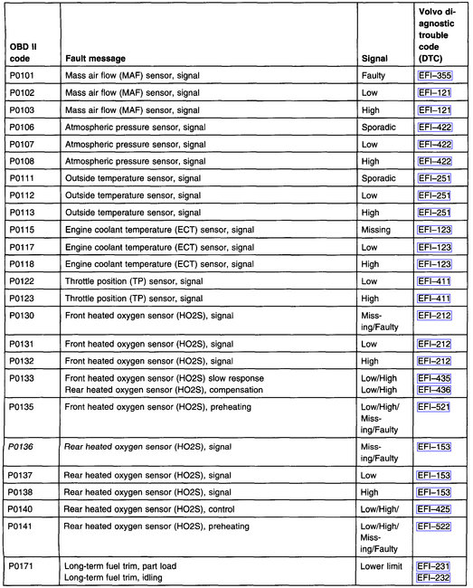

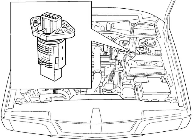

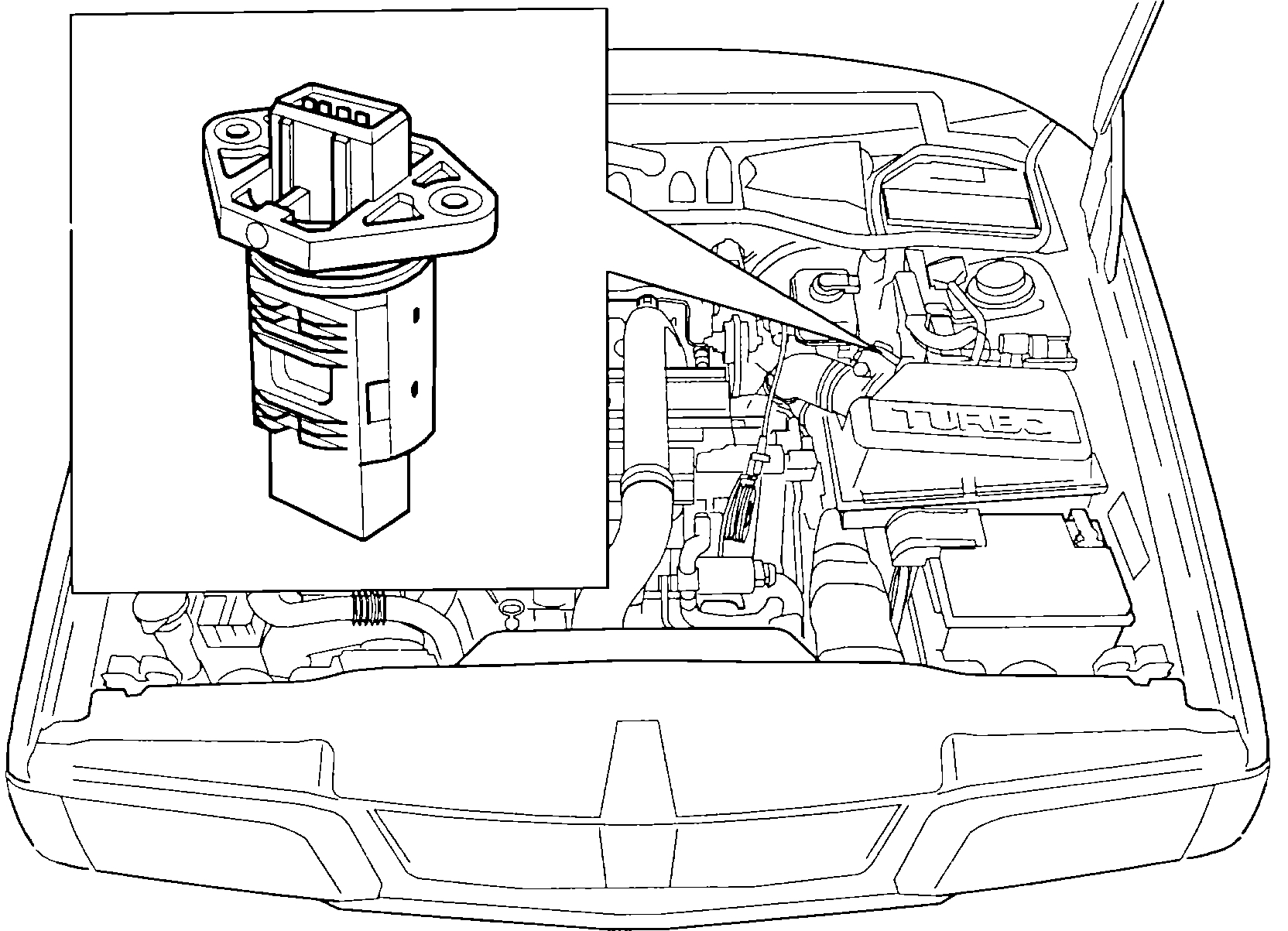

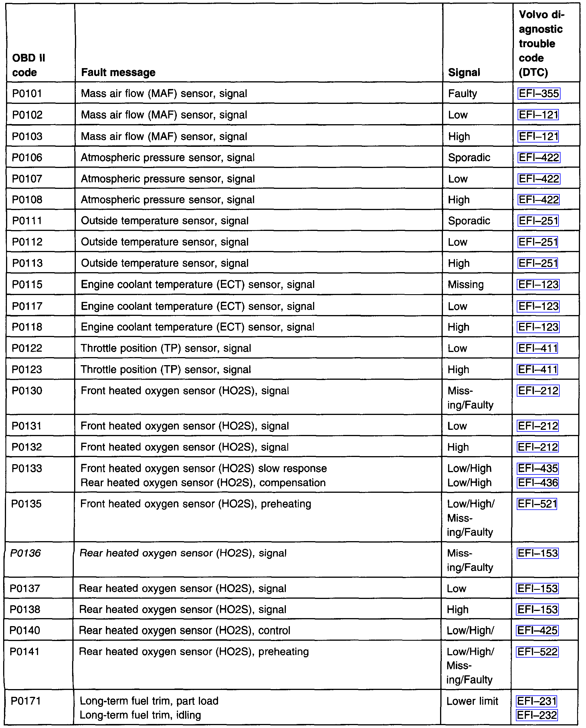

That code indicates a weak signal from the MAF. There is a good chance a connection is corroded or loose, or the sensor itself is bad. Here is a link which describes the process of cleaning one. Check through it to see if you missed anything.

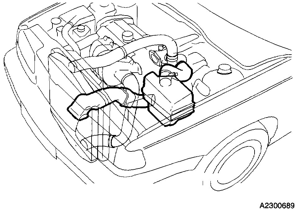

- Blocked Air Cleaner (ACL) or air intake.
Checking Air Intake
- Check air intake in front of the radiator, air duct, air cleaner (ACL) housing and air cleaner insert for signs of blockage (leaves, paper etc).

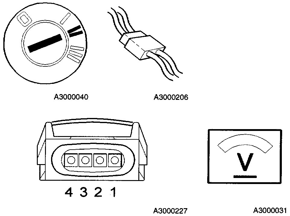

Checking Mass Air Flow Sensor
- Ignition ON.
- Mass Air Flow (MAF) Sensor connected.
- Connect a voltmeter between mass air flow (MAF) sensor connector terminals 2 and 4.
Voltmeter should read 0.1 - 0.2 Volts.
If reading is OK:
- Proceed to Checking Ignition Cables, Distributor Cap and Rotor section.
If reading is incorrect:
- Fault-trace mass air flow (MAF) sensor.
