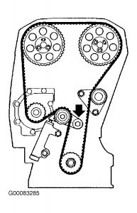

If timing belt strips will it bend the valves?? Also, do you have a diagram of timing belt for 1997 Volvo 850??
Dec 12, 2008 at 11:10 AM
BLUELIGHTNIN6
  • 16,542 POSTS
If your engine is an intereference engine (which I believe it is in the 850) then it is possible that slipping of the timing belt can cause damage to the valves and related components.
https://images.2carpros.com/forum/automotive_pictures/261618_Graphic_17.jpg
Need instructions on replacement? Just ask and you shall receive. Hope this helps.. Thanks for using 2carpros.com!
