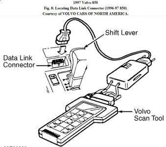

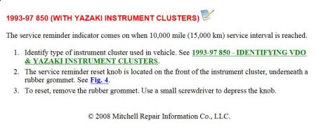

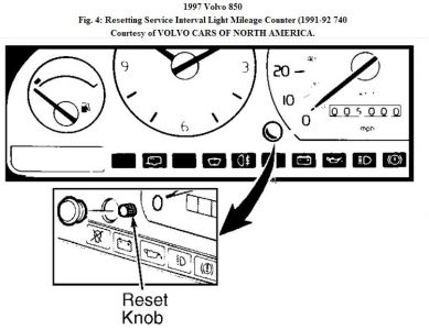

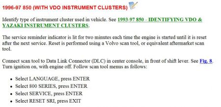

How do you turn off the engine oil service light? After we start the car the light comes on for a few minutes then goes off. I need to know how do reset the oil service light, or better yet disable it.

Hi symphonysid, Here are the procedures.
https://images.2carpros.com/forum/automotive_pictures/192750_ServiceReminder97Volvo850a1_1.jpg
https://images.2carpros.com/forum/automotive_pictures/192750_DLC97Volvo850_1.jpg
https://images.2carpros.com/forum/automotive_pictures/192750_ServiceReminder97Volvo850a2_1.jpg
https://images.2carpros.com/forum/automotive_pictures/192750_ServiceReminder97Volvo850a2a_1.jpg
