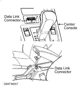

The transmission warning light (blinking arrow) goes on an off periodically. The transmissions seems fine when the light goes off. According to what I have read on the matter, it might be the selonoid that needs to be changed . If this is the solution, what might I expect this to cost?

Hello .. thanks for the donation .. much appreciated We cannot quote repair cost's untill we know the actual fault ! have the vehicle plugged into a diagnostic scanner/computer to retrieve the fault codes on the cars TCM .. repost with full fault codes for a better diagnosis and repair information ! SELF-DIAGNOSTICS Signals from various sensors are monitored continuously by TCM. If certain signals are lost or become faulty, TCM will cut off electrical signal to transaxle components to protect transaxle. TCM adopts fixed substitute values (limp-home mode) to enable vehicle to be driven when certain failures occur. Warning indicator light will illuminate. Transaxle will not shift gears due to lack of electrical signal. Transaxle will operate in 4th gear in "D", and in 3rd gear in "L" position. Manual shifting is possible into all other shift lever positions. When starting off in limp-home mode, shift lever should be in "L" position to minimize transaxle wear. Faults are recorded in TCM memory in the form of Diagnostic Trouble Codes (DTCs). On 1995 vehicles, DTCs can be displayed using LED on Volvo diagnostic unit in engine compartment, using Volvo Diagnostic Key Scan Tool connected to Volvo Data Link Connector (DLC) in engine compartment, using Volvo System Tester Scan Tool connected to Volvo Data Link Connector (DLC) in engine compartment, or using an aftermarket scan tool connected to On-Board Diagnostics II (OBD-II) Data Link Connector (DLC). OBD-II DLC is located in center console in front of gear shift lever. Using OBD-II DLC and scan tool will only output OBD-II DTCs, and not entire range of DTCs. See Fig. 5 and Fig. 6 . On 1996 vehicles, DTCs can only be accessed using scan tool connected to DLC located in front of gear shift lever. Scan tool will output entire range of DTCs. On 1995 vehicles, on-board Volvo diagnostic unit for retrieving codes is located in right front of engine compartment. Diagnostic unit is equipped with an LED indicator, activation button and function select cable. Fig. 6: Locating Data Link Connector (DLC)
https://images.2carpros.com/forum/automotive_pictures/266999_vol_1.jpg
Hope this helps

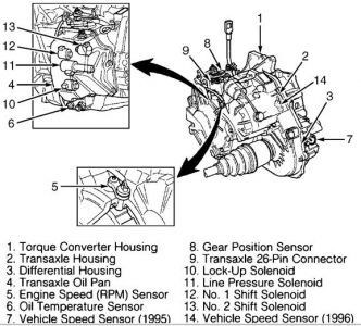

The trouble code is P0705 Transmission range sensor circuit (PRNDL Input)

Hello ... labor time for replacement of the sensor is 1 hour and for the adjustment is 30 minutes... I do not have a price listed for the part. Your local autoparts store or dealer should be able to supply current price .. the price will be a lot less than having the transmission replaced or rebuilt !! DTC 313/P0705: GEAR POSITION SENSOR SIGNAL INCORRECT If DTC 313 is set, check gear shift position sensor adjustment. Ensure gear shift is set to "N" position. Remove battery, battery shelf, and air intake manifold. Remove transmission cable from rod arm. Remove selector lever. Install gear position Alignment Tool (999 5475) on control shaft. If shaft is set correctly to "N" position and indentation on alignment tool aligns with mark on gear position sensor, go to step 3). If indentation does not align with mark, go to next step. Remove dipstick pipe bracket and gear position sensor screws. Rotate gear position sensor so mark on switch aligns with indentation on tool. Tighten sensor screws to 37 ft. lbs. (25 N.m). To complete installation, reverse removal procedure. Ensure ignition is off. Connect ohmmeter between gear shift position sensor case and transmission housing. If ohmmeter reads about zero ohms, go to next step. If ohmmeter does not read about zero ohms, check gear shift position sensor ground. Repair as necessary. Ensure ignition is off. Connect measuring unit to TCM connector. Check TCM grounds. See WIRING DIAGRAMS . Repair as necessary. If grounds are okay, connect ohmmeter between measuring unit terminal No. 20 and terminals No. 3 ("A"), No. 4 ("B"), No. 5 ("C"), and No. 6 (PA). If ohmmeter reads infinite resistance, go to next step. If ohmmeter does not read infinite resistance, check for short circuit to ground in White, Yellow, Green, and Blue wires between gear position sensor and TCM. Ensure ignition is off. Disconnect transaxle connector. Connect ohmmeter between transaxle connector terminals and measuring unit terminals. See TRANSAXLE CONNECTOR/MEASURING UNIT TERMINAL RESISTANCE table below. If ohmmeter reads about zero ohms for all readings, go to next step. If ohmmeter does not read about zero ohms for all readings, check for open circuit in wiring between transaxle connector and TCM. Repair as necessary. TRANSAXLE CONNECTOR/MEASURING UNIT TERMINAL RESISTANCE Transaxle Connector Terminal.....Measuring Unit Terminal 1 (White wire).............................3 2 (Yellow wire)............................4 3 (Green wire).............................5 4 (Blue wire)................................6 Ensure ignition is off. Disconnect transmission and TCM connectors. Turn ignition on. Connect test light between measuring unit terminal No. 20 and gear position sensor connector terminals No. 1 (White wire), No. 2 (Yellow wire), No. 3 (Green wire), and No. 4 (Blue wire). If test light comes on, check wiring for a short circuit to voltage. If test light does not come on, go to next step. Ensure ignition is off. Connect TCM and transaxle connectors. Turn ignition on. Using scan tool, go into SCROLLING VALUES. Read gear shift sensor position. Move gear shift position sensor to all shift positions several times. Repeatedly select same position to check operation. If all values are okay, DTC was caused by poor terminal contact. If all values are not okay, replace gear shift position sensor.
https://images.2carpros.com/forum/automotive_pictures/266999_vol_2.jpg
GEAR POSITION SENSOR NOTE:Gear position sensor may also be referred to as neutral safety switch. Removal & Installation Ensure transaxle is in "N" position and parking brake is applied. Remove battery, battery tray and air intake hose. Remove air cleaner assembly. Disconnect transaxle cable from shift rod arm. Remove shift rod arm from sensor. Note position of notch on sensor for installation reference. Remove nut, washer and seal from sensor. Loosen dipstick bracket. Remove 2 bolts securing sensor to transaxle. Remove sensor from control shaft. Separate the connector on transaxle. Disassemble connector. Remember rubber gasket. Disconnect cable clamps and detach connector from transaxle. Remove sockets from connector casing. Remove rubber seal from connector. Insert screwdriver between casing and socket and press catch in. At the same time slide the sockets out of the casing. Detach socket for gear position sensor (8-pin) from other sockets. Remove gear position sensor. Reassemble position sensor socket with the other sockets. Reinstall sockets in casing and put rubber seal back in place. Reinstall connector on transaxle. Reinstall cable clamps around cable harness and rubber seal. Reinstall upper connector section. Remember rubber gasket. To install, reverse removal procedure. Ensure notch on sensor is located in exact position as prior to removal. Tighten 2 sensor bolts to 18 ft. lbs (25 N.m). If adjustment is necessary, see GEAR POSITION SENSOR under ADJUSTMENTS in AUTOMATIC TRANSMISSION SERVICING VOLVO article. Hope this helps .. let me know if you need any more assistance
