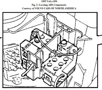

How do you check for sensors malfunctions . reverse sometimes.no reduction in rpm when in reverse.

Hi peddler, You can use the onboard diagnostic to check for DTCs.
https://images.2carpros.com/forum/automotive_pictures/192750_Diagnostic95Volvo850_2.jpg
Plug the selector cable into #1 socket for TCM diagnostic. Press button for more than 1 seconds but less than 3 seconds and count the number of blinks. It is in codes of 3s.
