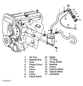

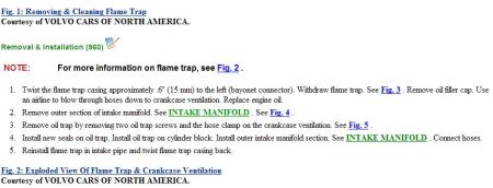

1996 Volvo 850 OIL PUSHING OUT OF FILLER CAP
1996 VOLVO 850
CLINTONPAUL
Engine Cooling problem
1996 Volvo 850 Two Wheel Drive Manual 103841 miles
I HAVE BEEN TO AGARAGE AND THEY DO NOT NO WERE THE OIL BREATHER IS THE ENGINE NUMBER IS 760374
Aug 26, 2008 at 4:23 AM
MHPAUTOS
  • 31,937 POSTS
Hi there, Breather & flame trap pic and service info as per pics. Mark (mhpautos)
