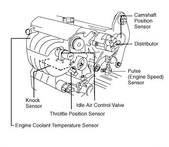

I have a 1995 volvo 850 turbo... and the check engine light is on its showing the code for the knock sensor.. i was planning on puting it on my self but have no idea were it is ive spent alot of time looking for it and cant find it any help would be great thanks.

Almost above the starter left side of the engine here what I have for location good luck let me know
https://images.2carpros.com/forum/automotive_pictures/99387_volvo850_1.jpg

well i think i know were it is now. Its UNDER the INTAKE manifold ( you cant see it with the hood poped) i tired today on my lunch break with my buddie to try and figure out were it was. we tried going from under the car jacked up and no luck. we do know its under the manifold because thats the only spot we cant see. what do you think? take off the intake manifold or go for it from underneath? any more help would be great, thanks.
