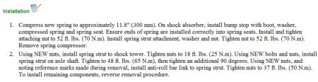

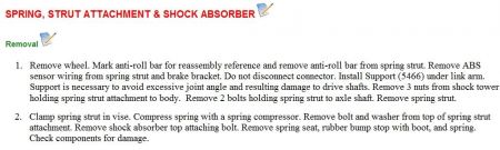

1994 Volvo 850 Front Wheel Drive Automatic 137000 miles
I would like to replace my front struts. What parts are necessary? Is there a base plate to be replased at the bottom of the strut?
5 cylinder engine turbo

https://images.2carpros.com/forum/automotive_pictures/261618_Noname_2531.jpg
https://images.2carpros.com/forum/automotive_pictures/261618_Noname2_824.jpg
