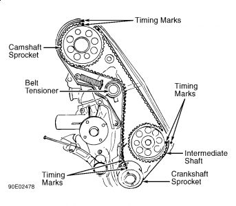

CAR JUMPED TIME AND DIED SO I TOOK, THE COVER OFF THE TIMEING BELT AND NOTICED THE ROLL PIN WAS BROKE SO I GOT A NEW ONE AND I NEED TO NO THE CORRECT POSITION FOR THE GEARS OR HOW TO ALIGN THE DOTS ON THE GEARS

turbo or normally aspirated engine?

TURBO

does this help?..
https://images.2carpros.com/forum/automotive_pictures/261618_Graphic_218.jpg

WOW THANKS SO MUCH
