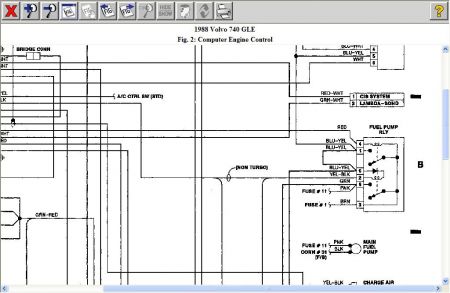

I have an 88 volvo 740 4 cyclinder,im not getting any fuel to the engine.i have changed both fuel pumps and relay and filter i cant hear the fuel pumps come on,any ideas?

Have you checked the fuses for the fuel pump. fuse no.11 and no.1?
Apr 27, 2008 at 7:51 AM
MISTER4U
  • 5 POSTS
acually yes,i did check the fuses,
Apr 27, 2008 at 8:31 AM
  • 75,992 POSTS
Breakout the voltmeter and test for power at the fuel pump relay female side with the red wire.
Apr 27, 2008 at 8:33 AM
MISTER4U
  • 5 POSTS
I dont seem to be getting anything on the female side..
Apr 27, 2008 at 2:33 PM
  • 75,992 POSTS

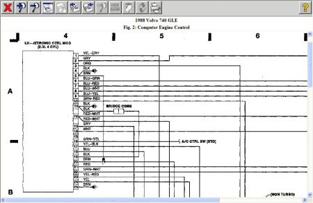

Fuel pump circuit also check the radio interference suppression relay
https://images.2carpros.com/forum/automotive_pictures/12900_relay1_2.jpg
https://images.2carpros.com/forum/automotive_pictures/12900_relay2_1.jpg
Apr 27, 2008 at 2:43 PM
EDRUNNER
Was this problem solved? If it was, it sure will help me. I have the same exact problem on my neighbor's 1989 740 GL station wagon. There's always power to fuse #1 (main pump) even when ignition switch is Off but none on #11 (in-tank pump) even when engine is cranked. When I connected the in-tank pump wire (pink) to #1 fuse spare connector, the pump ran. At least I know the wiring from the relay to the in-tank pump is fine. I don't know why there's no power to the in-tank pump. I'm guessing it's between the relay terminal and the ignition swith or the ECU. Is it? I don't want to change the ECU until I've done other tests which I don't know. Can you tell me what they are? A mechanic said it could be the crankshaft position sensor. Is this correct? Any ideas will be greatly appreciated. I've donated before on a different question as Ed51 but can't access my account so I'm on a new account name.
Aug 3, 2009 at 2:45 AM
EDRUNNER
Put direct power to In-tank pump and it ran. With the ignition On there's no power to the main fuel pump. Whe engine is started the main fuel pump also does not run. It runs only when a test light probe touches its blue-yellow wire at the relay terminal. (The fuel pump relay is brand new by the way). We did it this to make sure the new pumps we installed runs and know that there is gas going to the fuel rail. Engine still won't start. Thinking it's the injectors. The Computer Engine Control diagram shows wiring from the Radio Suppression Relay to the injectors and ECU and to the MAF, IAC and ECU. I'm guessing it could also be the Radio Suppression Relay or the ECU that's bad. I'm using Fig. 4: Computer Engine Control diagram ( LH-Jetronic, 16 Valve) diagram. Engine is B230F. Any ideas will be greatly appreciated.
