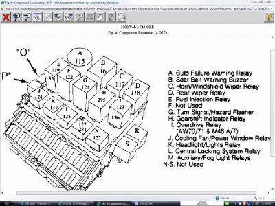

I have an 88 volvo 740,i dont seem to be getting any fuel thru the fuel line going to the injecters,ive changed both fuel pumps,and fuel filter ,and fuel relay switch,can anyone help..thanks

Have you check the pump's electrical connector for power? Could be a short to ground...and look in the underhood fuse/relay center for any fuel circuit fuses...if it's a 2.3 turbo, look at the fuel ballance resistor at the left front of the engine compartment.
https://images.2carpros.com/forum/automotive_pictures/62217_Relays_4.jpg

where would the fuses be located under the hood i could see a fuse center anywhere,just the one behind the ash tray?
