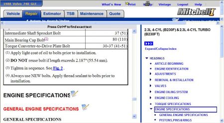

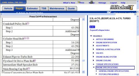

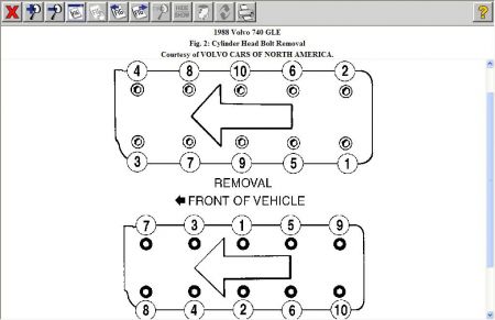

head bolt torque
Saturday, November 29th, 2008 AT 2:02 PM
MECHANIC
75,992 POSTS
Here you go
