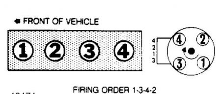

which cylinder is cylinder number 1, on a 1988 volvo740gl?
May 17, 2010 at 10:16 PM
  • 75,992 POSTS
https://images.2carpros.com/forum/automotive_pictures/12900_fov_1.jpg
May 17, 2010 at 10:30 PM
