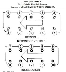

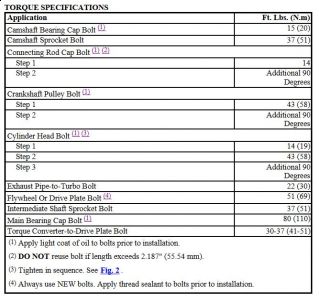

what is the torque spicification on the cylinder head bolts, the main bearing caps and the conrod bearings
Jul 1, 2009 at 3:54 AM
KHLOW2008
  • 41,814 POSTS
Hi carlspence, Here are the specs.
https://images.2carpros.com/forum/automotive_pictures/192750_TorqueSpec88Volvo40_1.jpg
https://images.2carpros.com/forum/automotive_pictures/192750_CylinderHead88Volvo740_1.jpg
