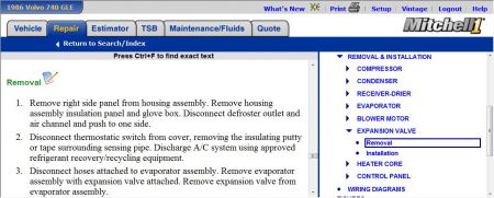

Hi, Where is the expansion vale located and do you need to take out evaporator for that? Thanks.

See below
