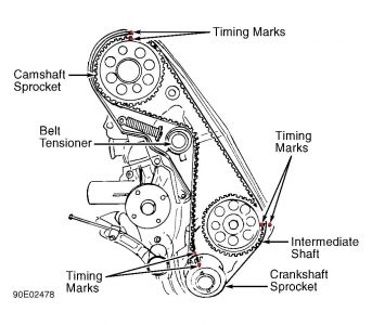

i had a problem with my head gasket and i changed it but now i cannot set back the timing i need to get a diagram because my gears seem to not have the marks on them

2.3l engine
https://images.2carpros.com/forum/automotive_pictures/99387_volvo74o_1.jpg
