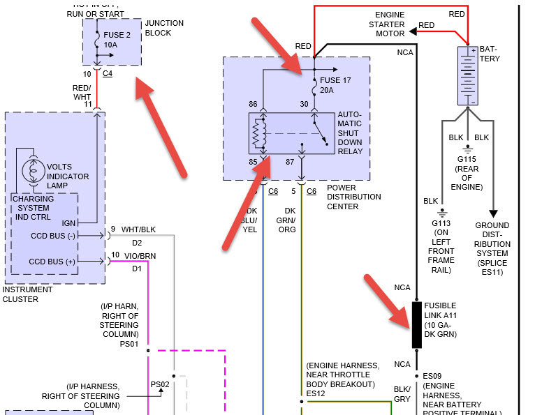

I recently put in a new ECU due to my battery discharging over a week or so. I also installed a re-manufactured ECU. I cleaned the battery terminals and battery, cleaned the wire connections at the power distribution box, had the alternator pulled apart diodes and rotor short test performed which test fine. I had new brushes installed for the heck of it, I had the van scoped with the first re-manufactured ECU and everything tested fine including voltage drop tests etc. except for the ecu driver was reported bad. The ecu had a lifetime limited warranty so the seller all computers inc. sent a second ECU. after installation same problems. I tested the field wire on the ECU and it tested with engine running from cold no load 5.8v with engine revved it went down to 2.5v or close to it. the voltage measured 13.85v. Once at full load the field wire tested at 11.5 to 12.20v at idle and stayed there with the engine revved. I then tested the positive wire that runs to the alternator (the small one not the big one) at the ECU and it measured exactly what i got at the battery with the engine running under all loads and conditions. also measured the negative ground into the ECU and read a 0.04v drop between what was at the battery and what was at the ECU. I also hooked a jump starting cable directly to the alternator case and the battery negative post with no changes in voltage both at the ECU wires and the voltage at the battery. I also removed the alternator wire from the power distribution box and left the battery cable hooked up thus running the engine on only battery power and eliminating the risk of blowing electronics. I started the engine and got 29v at idle and 50v with engine revved. I cannot figure out why the voltage output is not at least 13.8v under full load. does anyone have any ideas or is it just a bad driver again? what is a ECU driver anyway? is that the software program it uses or something else?

so in short your battery is not charging from the story I just read. it is probably not the ECU. check items in picture, like for corrosion and wiggle wires around fusible link as it may only be connected by a couple of strands. if it is still messing up, check for connection problems at PCM as well as alternator. finally have a local professional scan for codes to see if the body module is the problem. or a BUS problem within dash or body module.

Thanks for your help. I am not seeing the picture your speaking of in your answer. Do you know where the main ground points are located So I can assure they are not corroded?

sorry I goofed the grounds are at left front frame rail and rear of engine. here is picture. check these fuses and fusible link it may only have a few strands connected causing the problem. then have it scanned because it may be a can bus problem or body module which only a pro scanner can pick up. I in inadvertently marked the asd relay which should not be the problem. it can also be corrosion on fuses so if they are clean it and use dielectric compound which are in small tubes on a lot of parts counters about $2.00.
