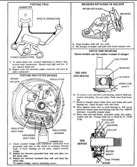

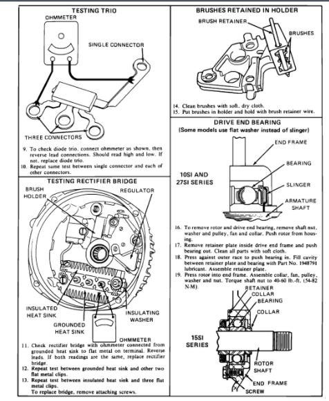

Can't seem to find information about location of the voltage regulator that's specific to my year model. Please help.

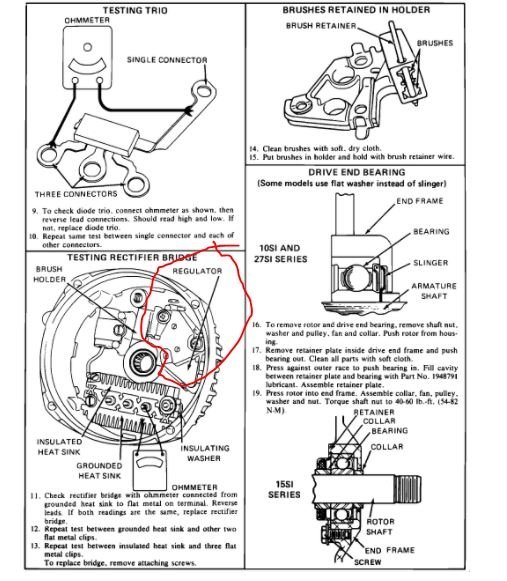

This alternator is a solid-state unit that incorporates an integral regulator. A vacuum pump is attached to the rear cover and is driven off the alternator shaft.
https://www.2carpros.com/articles/how-to-replace-an-alternator
There is no external regulator for this model.
