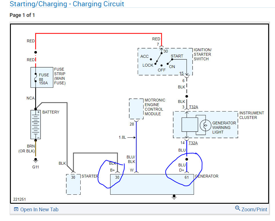

When first bought was acting like crazy i knew it was the battery, had it replaced and all good. Fixed a bunch of vacuum hoses, and so on. Recently she randomly will have the battery light on and off. Took it back to Walmart to check battery they said it was defective, replaced under warranty. Still, when i check volts when off it's 12.11, with lights on and engine off 11.80, with engine running as well as ac and lights 12.64, with engine on and ac and lights off 13.26. They also checked charging system there once and it was okay.

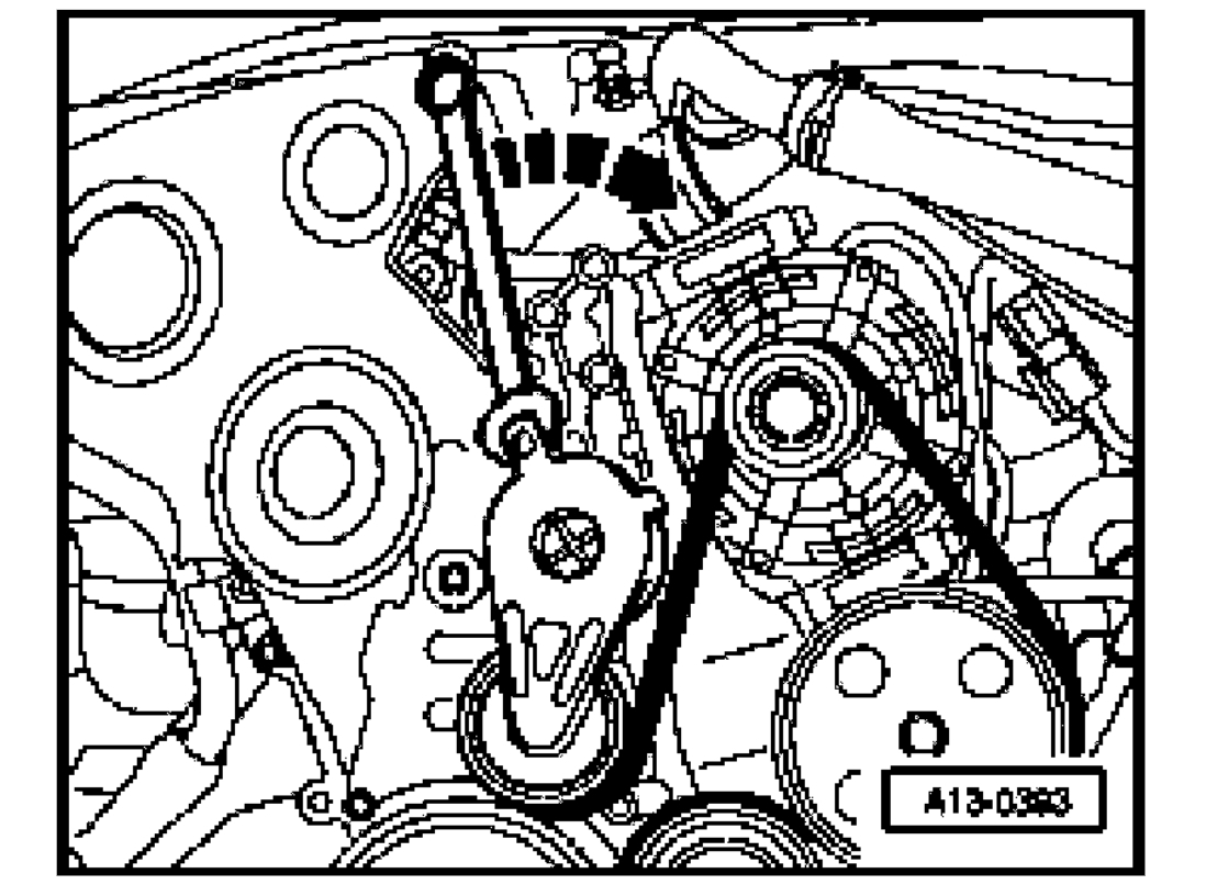

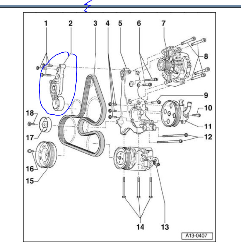

Just to add, this could be the belt slipping. Your voltage is low but rises at times. I attached the diagram of the belt and the tensioner for the system. If it is loose, the charge rate will be low.
https://www.2carpros.com/articles/serpentine-belt-tensioner-replacement
I attached a diagram as well for you of the charging system. Your voltage should be 14 to 14.5 volts running.
