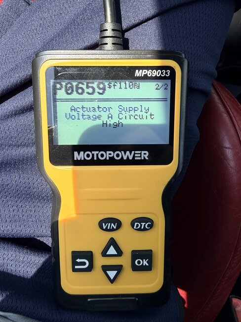

Had someone teat drive the car then when he came back all was good and he parked it reverse. He left then i went to move the car and when i started it , it was just revving up and down with all lights on and the thunder light. Checked codes and cleared it and drove it home fine

The lightning-bolt symbol is the Electronic Throttle Control warning light.
P0659 — Actuator Supply Voltage “A” Circuit High
I would service the throttle body and then clear the codes, this guide can help
https://www.2carpros.com/articles/throttle-actuator-service/
Please let me know what happens.
