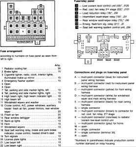

I have lost lights, windshield wipers, power windows.
Individual fuses seem fine.. Is there a main power fuse or relay to cover these items? Where would I find it and how do I recognize it?
Any other suggestions as to the problem?
This is a 1990 VW Vanagon Camper.

https://images.2carpros.com/forum/automotive_pictures/12900_f_12.jpg
