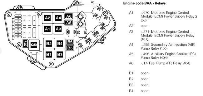

has intermittent cutting out/loss of power and surging problem. Has been at agents 9 times now. They have changed, plugs, coils, fuel pump and filter, crank sensor, knock sensors, throttle body - problem still there.
Apr 22, 2010 at 8:36 AM
MICK996
Hi ccball,
I had this problem and had to replace the Motronic ECU power relay cost me $54.00 here is the location. Check out the diagrams (Below). Please let us know what happens.
Jul 7, 2012 at 12:02 PM
