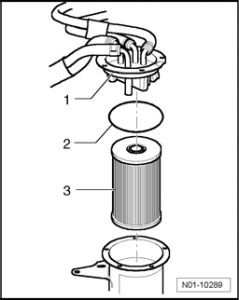

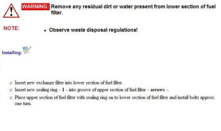

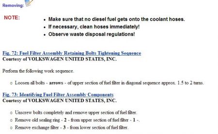

Once I buy a replacement filter, how do I go about changing the fuel filter on my 2006 Jetta TDI?
Thanks.
Monday, September 14th, 2009 AT 9:41 AM
BLUELIGHTNIN6
MECHANIC
16,542 POSTS
FIG. 72
FIG. 73
