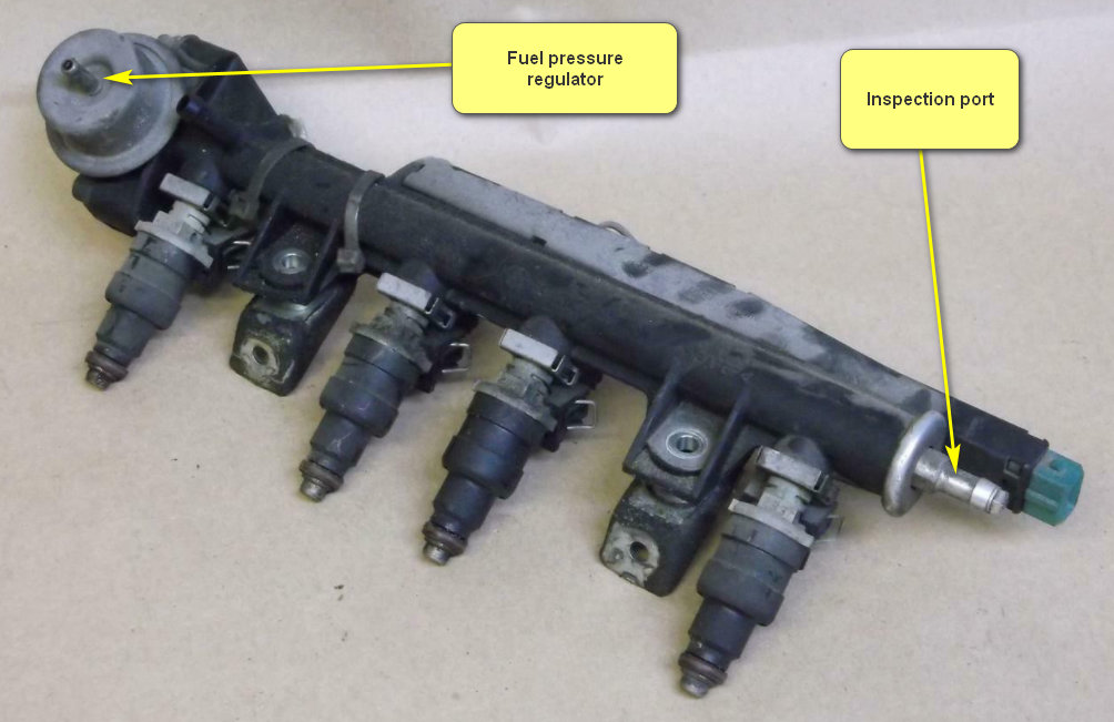

Your vehicle is equipped with the Digifant 2 fuel injection system.

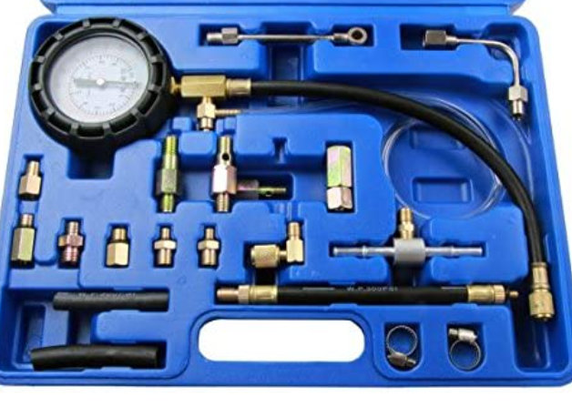

I would suggest to carry out a fuel pressure test first
Connect a suitable fuel pressure gauge to the check port at the fuel rail.
Please see second picture below
At idle we should see a pressure of 2.5 bar and with the vacuum line disconnected at the regulator we should see pressure of 3 bar.
Please take care when disconnecting the fuel lines as the will be under pressure
How to test fuel pressure on VW Digifant system.
https://youtu.be/qp8gcQSKlwQ
Please see picture below of fuel rail and inspection port.
Please let us know how you get along.
