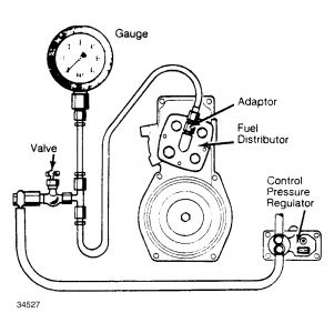

Install a pressure gauge to perform fuel pressure tests. On all models, pressure gauge is installed between the control pressure regulator and the center fitting on fuel distributor. See Fig. 5 .

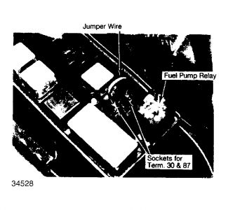

To operate fuel pump with engine not running, disconnect fuel pump relay from relay panel. Insert a jumper wire into sockets that correspond to terminals 30 and 87 on relay. See Fig. 6 .

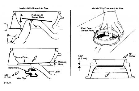

To operate fuel pump turn ignition on. Place pressure gauge as low as possible in engine compartment, then open and close valve 5 times to bleed gauge. Place valve in open position and hang in convenient location. Turn pump off.
AIR/FUEL MIXTURE CONTROL OR AIR-FLOW SENSOR Remove rubber bellows to expose air-flow sensor plate. Disconnect electrical connectors on auxiliary air valve and control pressure regulator, then operate fuel pump for ten seconds to build up control pressure.
Using extreme care not to damage sensor plate, lift sensor plate slowly with magnet or pliers. Constant resistance due to control plunger pressure should be felt throughout range of lift. Release plate slowly, lever and control piston should follow. See Fig. 7 .

Lift plate, then return it rapidly to lower position. The piston moves more slowly and should be heard hitting the lever. If not, control piston is sticking. Remove 3 screws from fuel distributor and lift off of air flow sensor housing. Be careful not to drop control plunger. See Fig. 8 .

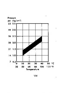

NOTE:Some models have a control pressure regulator with atmospheric pressure compensation. Pressures may vary slightly on these models. Fig. 9: Cold Engine Control Pressure Test Graphs WARM ENGINE CONTROL PRESSURE TEST Connect plug to control pressure regulator. Leave auxiliary air valve and air flow sensor (if equipped) plugs disconnected. Place valve for pressure gauge in open position and operate fuel pump. After about 5 minutes, pressure should rise to indicated level. See Fuel Injection Pressure Testing table. On models with vacuum hose connected to control pressure regulator, leave hose connected to read pressure. Start engine and allow to idle. Pressure should remain the same or rise slightly. On models with control pressure regulator vacuum line, remove and plug hose. Pressure should drop. If pressure does not reach level specified, disconnect plug at control pressure regulator. Check for voltage across terminals with test lamp or voltmeter. At least 11.5 volts should be present. If not, check wiring. If voltage is present and pressure not correct, replace control pressure regulator.
FUEL INJECTION PRESSURE TESTING Application Specifications: psi (kg/cm2 )
Line Pressure68-78 (4.7-5.34
Warm Control Pressure49-55 (3.4-3.9)
Rest Pressure36 (2.4)
Nozzle Opening Pressure51-59 (3.6-4.1)
SYSTEM (LINE) CONTROL PRESSURE TEST
Close valve on pressure gauge. With engine off, operate fuel pump. Pressure should rise to level specified. See Fuel Injection Pressure Testing table.
If pressure is too low, check fuel pump output. Disconnect fuel return line from fuel distributor and run a hose from fuel distributor to container.
Operate fuel pump and measure output after 30 seconds. See Fuel Pump Output Specifications table. If not as specified, check fuel lines, filter, fuel accumulator, and fuel pump.

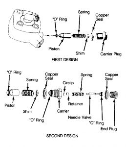

If pressure is too high, check for kinked or blocked fuel return line. If lines are clear, system pressure regulator must be adjusted. Turn pump off, loosen return line fitting, and relieve pressure.
Loosen line pressure regulator nut. Remove shims, spring(s) and plunger. Raise system pressure by adding shims; lower pressure by removing shims. Be sure "O" rings are in good condition. If piston is scored or damaged, fuel distributor must be replaced. See Fig. 10 .

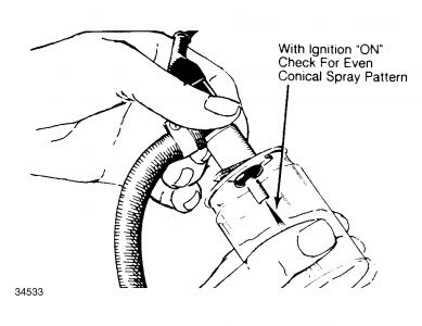

Remove cold start valve from manifold but leave fuel line connected. Place valve in a container. See Fig. 11 . Connect a jumper wire from one terminal to ground, and from other terminal of cold start valve to a switch. The other side of switch should be connected to a source of battery voltage.
CAUTION: Do not connect wire directly to battery. Extreme fire danger is probable due to atomized fuel. Sparks may result if wire is touched to battery.
Operate fuel pump. Turn switch to "ON" position. Cold start injector should spray. Turn switch "OFF", but leave fuel pump running. Injector should not spray. Wipe off nozzle and check for leakage. With pump running, no drops should form within one minute.

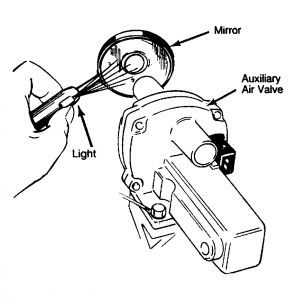

AUXILIARY AIR VALVE
Disconnect hoses from auxiliary air valve. Use a mirror and small flashlight to inspect valve. See Fig. 13 . At room temperature, valve should be slightly open. If equipped, disconnect wires from air flow sensor. With ignition switch "ON" valve should cover opening within 5 minutes.
https://www.2carpros.com/forum/automotive_pictures/307270_fig_13_1.jpg
https://www.2carpros.com/forum/automotive_pictures/307270_fig_12_1.jpg
If valve does not operate properly, check for power at connector with engine running. Connect a test lamp across connector terminals. If lamp does not light, check fuse and wiring.
If lamp lights, check resistance of auxiliary air valve. If no resistance is measured, valve is defective. Ensure electrical connections are tight and terminals are clean, prior to measuring resistance.

Remove fuel pump relay and connect jumper wire across sockets corresponding to terminals 30 and 87. If equipped, remove plug at air flow sensor. Turn ignition "ON".
Frequency valve should operate, making a buzzing noise. Dwell meter should indicate 45-65 °. Disconnect wire from oxygen sensor and touch wire end to ground. Readings on dwell meter should rise. Ground one end of a 1.5 volt flashlight battery, and touch positive end to sensor wire. Readings should drop to less than 15 °.

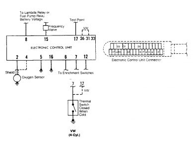

Fig. 13: Bosch CIS Lambda Electronic Control Unit Wiring Diagram,

NOTE:Electronic control unit is located near glove box.
Locate electronic control unit and press locking tabs back to disconnect connector. All connectors are wired with pin numbers in the same location. Obtain a high-quality volt-ohmmeter for testing.
Refer to wiring diagram for pin locations. With ignition "ON" and fuel pump jumper wire in place, check for battery voltage at terminals 8 and 15. Connect ground lead of voltmeter to terminals 5 and 16 while checking for battery voltage to ensure these wires make a good ground connection.
If battery voltage is not available at terminal 8, check Lambda and fuel pump relays. If no voltage at 15, check frequency valve connector. One wire should have battery voltage; the other wire should have continuity to terminal 15. Frequency valve should have 2-3 ohms resistance. Repair or replace as necessary.

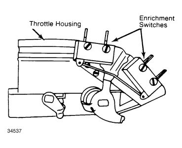

Fig. 14: Throttle Enrichment Switches
Disconnect oxygen sensor and check for continuity between sensor lead and terminal 2 (4 on Mercedes-Benz). No continuity should exist between ground and lead wire.
All models use enrichment switches. See Fig. 14 . All switches provide continuity to ground when switch is closed. Actuate throttle to test throttle switches.

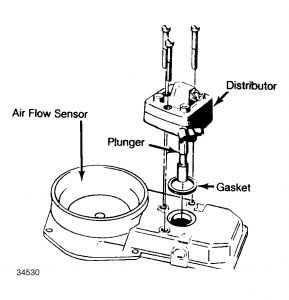

FUEL DISTRIBUTOR
Remove mixture control unit. Remove 3 screws from top of fuel distributor. Lift off carefully, ensuring that plunger does not fall out of distributor.
Only pressure regulator shims may be replaced. If plunger or piston is scored, replace fuel distributor. Be sure "O" ring is in place and in good condition when replacing unit.

BRUCE VANDIVER
All Bosch CIS injected VWs that sit for too long wind up with this symptom. The culprit is almost always a bad ground connection or a bad Oxygen sensor relay that affects the power supply to the Lambda valve, or frequency valve, -or in later models the differential pressure actuator valve. All these valves are located on the side, or near the side of the fuel distributor. You can identify the type you have by shape. The Lambda or frequency valve is round with fuel lines coming from each end. It looks a lot like a small electric-pulsed type fuel injector. The differential pressure actuator valve is square shaped and is attached to the side of the fuel distributor.
The frequency valve makes a loud, distinct buzzing noise when operating correctly. If you are not certain it's running, place a long handled screwdriver against it and listen by placing the handle to your ear. You should hear a clear BUZZZZZ! If yours is quiet, that's your problem. This presents as a symptomatic rough idle with stalling on rev-up of the engine or acceleration of the car. Basically you can't load the engine at all. The car will start and barely run but it's not drivable. This problem is typically due to a bad relay or electrical connection. First check for a faulty oxygen sensor relay, then check for bad ground connection where the ground wires attach to the intake manifold near the "cold-start" fuel injector valve. There are usually two sets of brown wires that attach here. Pull each and clean. Test for continuity. Most of the problems I fix are right there. Finally, pull the electric connection at the frequency valve and use a multimeter to check for voltage on one of the two connectors in the harness. That connector is VERY HARD to remove, as the wire retaining clip is difficult to release. Be careful and don't break it. So. If you have voltage in one of the harness connectors, next check the frequency valve windings for resistance. Correct resistance is 2 to 3 ohms. Any other reading means bad frequency valve.
Troubleshoot of the differential pressure actuator valve is similar, please refer to Bently manual.
