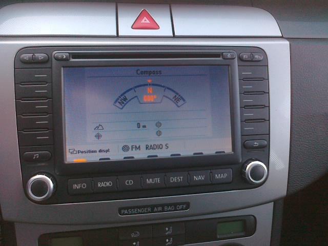

COKICA
Dears all,
I have problem with compass on Passat 2.0 from 2007y. with MFD2 navi.
Everything works normally until I replaced the battery. Since then, all at zero as seen in Fig. What do I do?
Kind regards and thank you in advance!
Nov 8, 2013 at 1:24 AM
