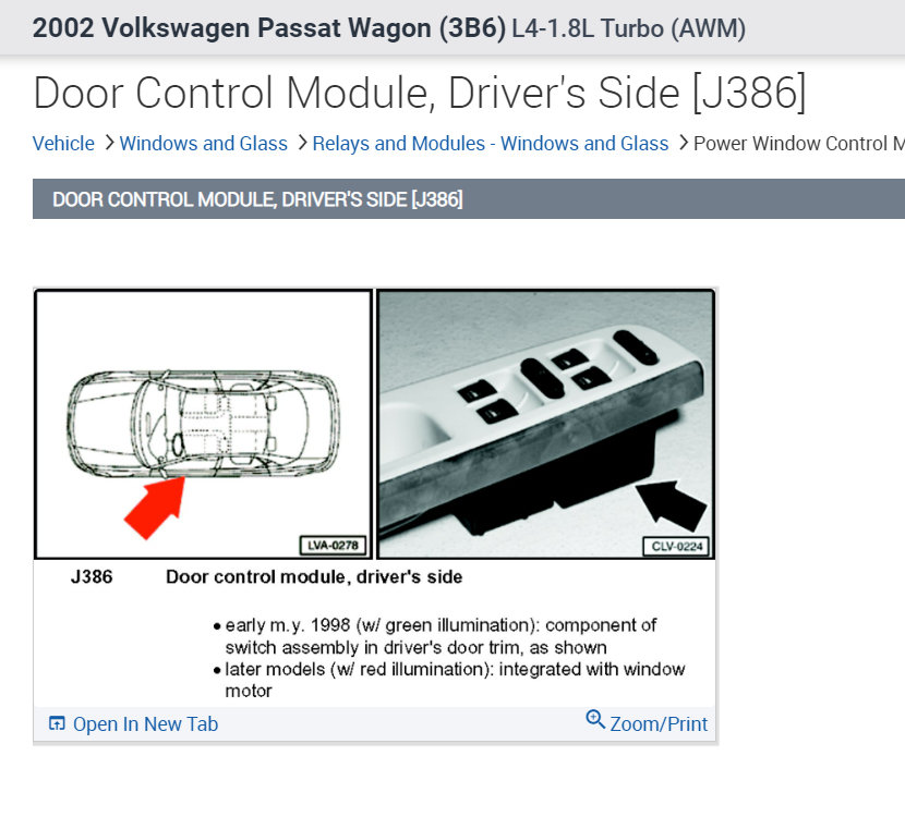

DANIEL SMITH
I am having this same problem. There is a trailer connector spliced in, but it was there before I bought the car and this problem just started. I am also having a problem with the fuses from the windows, door, and lift gate locks blowing as soon as replaced.
Jul 5, 2022 at 3:46 AM
  • 55,423 POSTS
If you don't use the trailer light connector, I would follow it and remove and repair the wiring as needed. These cars have a problem with the drivers door module getting wet, or damaged due to many door closes. I would unplug the DDM and see if the fuses blow, here is the location. Check out the diagrams (below). Please let us know what happens.
