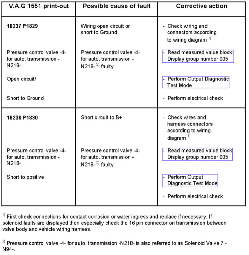

came up with p1829 code?
2002 VOLKSWAGEN PASSAT
67,555 MILES • 6 CYL • 2WD • AUTOMATIC
GARYDAONE
the check engine lite came on and I had some one at auto zone read the code for me and came up with p1829 can i still drive the car and what am I up against here...?

The code:
P1829 : Pressure Control Solenoid 4 Open/Short to Ground
This is a transmission fault code. This is likely an issue with the wiring for the transmission control solenoid.
https://www.2carpros.com/trouble_codes/obd2
I have attached the diagnostics for that code (look below).
