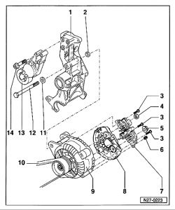

Generator (GEN), Removing And Installing CAUTION! Before beginning repairs on the electrical system: *Obtain the anti-theft radio security code. *Switch the ignition off. *Disconnect the battery Ground (GND) strap. *After reconnecting battery, re-code and check operation of anti-theft radio. Special tools, testers and auxiliary items needed
https://images.2carpros.com/forum/automotive_pictures/12900_a1_5.gif
*VAG 1331 Torque wrench (or equivalent 5 - 50 Nm)
https://images.2carpros.com/forum/automotive_pictures/12900_a2_19.jpg
1 - Bracket *Hex nut *M8 x 85 mm *30 Nm (22 ft. lb.) 3 - Screw 4 - Hex nut *M8 5 - Hex nut 6 - Screw 7 - Voltage Regulator (VR) *Carbon brushes, checking 8 - Protective cap 9 - Generator (GEN) *Securing B1+ wire to generator 10 - Ribbed belt 11 - Washer 12 - Hex bolt *M8 x 85 mm *25 Nm (18 ft. lb.) *Remove viscous fan to access bolt. 13 - Tensioning - roller 14 - Hex socket bolt *M8 x 85 mm *25 Nm (18 ft. lb.) https://www.2carpros.com/kpages/auto_repair_manuals_alldata.htm
