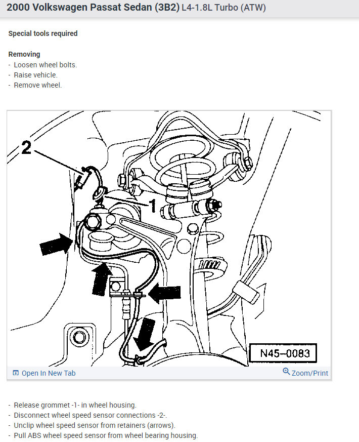

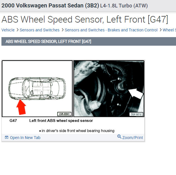

need to replace the wheel speed sensors in the front.
2000 VOLKSWAGEN PASSAT
140,000 MILES • 4 CYL • 2WD • AUTOMATIC
URANIUMZ
I am getting the brake fault message on my HUD. I was told when I bought the car that the brakes are new, just need to replace the wheel speed sensors in the front.
Jul 28, 2009 at 5:06 AM
SQM
  • CAR REPAIR CONTRIBUTOR
  • 6,383 POSTS

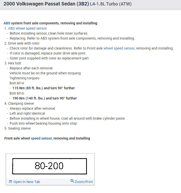

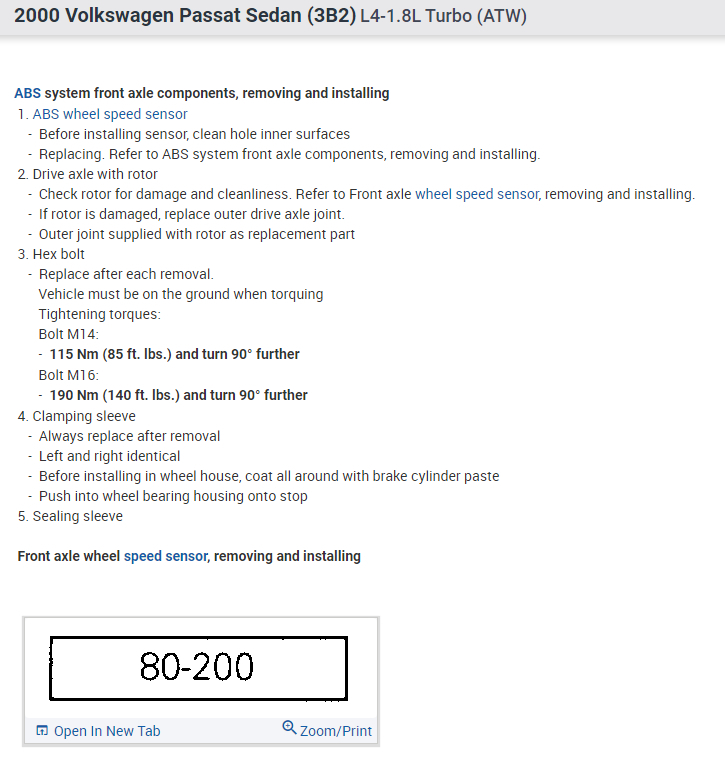

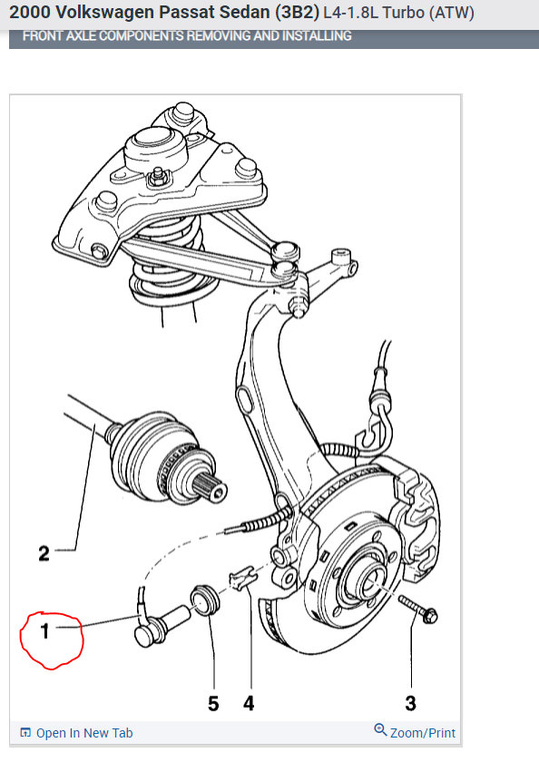

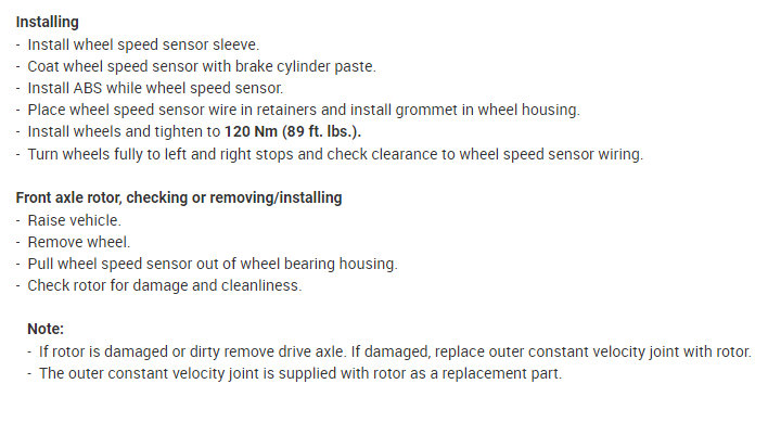

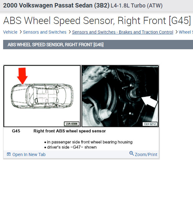

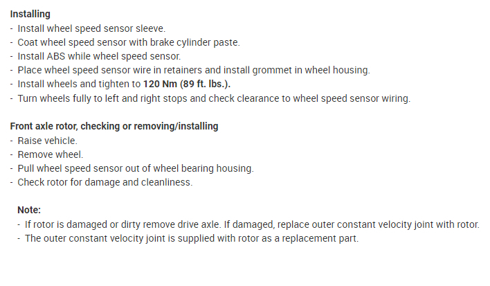

The ABS/Wheel speed sensor can be replaced easily and in a relatively short period of time.
Here is a helpful video on how to change the sensor:
https://youtu.be/ANWVTh2RQoQ
https://www.2carpros.com/articles/how-to-replace-an-abs-wheel-speed-sensor
After the installation you might have to reset the error light.
