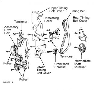

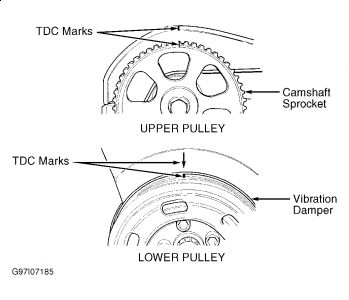

Hi there, this passat, is it the 1.8 liter engine? as this will be a single overhead cam, belt driven engine.
Mark (mhpautos)
https://www.2carpros.com/forum/automotive_pictures/61395_Graphic_138.jpg
https://www.2carpros.com/forum/automotive_pictures/61395_Graphic1_12.jpg

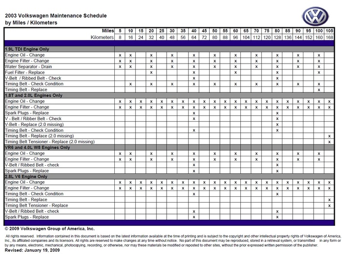

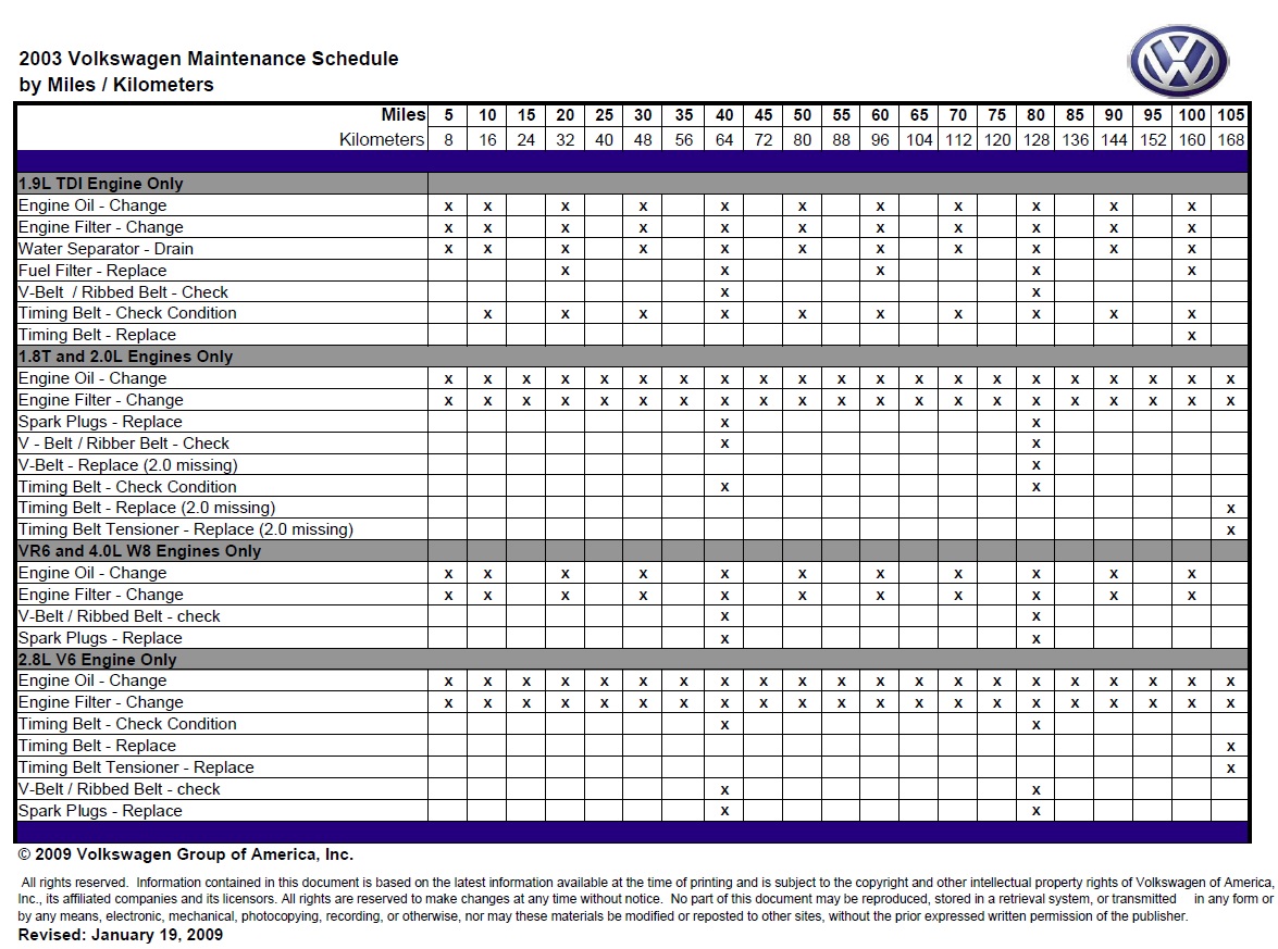

I am about to drive from NYC to Chicago. My car is being checked over at the VW dealership and they recommend replacing the timing belt. I want to sell that car this fall and don't want to sink that much money into it. Can I make the drive without replacing the timing belt?
Thursday, April 4th, 2019 AT 9:44 PM (Merged)
EXOVCDS
  • 1,883 POSTS
If the belt breaks. You will have much more $ to spend on repairs.
Yes, it might make the journey, but it's a 9 year old belt.
If it's a 1.8T engine with stock water pump (driven by the timing belt), the
pumps have been known to fail before the water pump.
In either case, cheaper to do now than later.

Timing belt replacement is reccomended at 60,000 miles. Doesnt' mean it has to be just reccomended. But it's better to be safe than sorry. When it is replaced you should put on a kit which would include the waterpump and new tensioner.
VWSCOTT
  • 66 POSTS
Per vw the t belt service isn't recommended til 105k on gasoline engines, that's what my info states.
