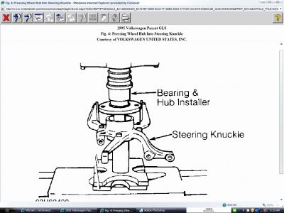

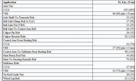

I cannot find the torque settings for the front wheel bearing on my vr6 and haynes don't cover my model.

Here ya go! Press in new bearing then torque to 66 ft lbs on axle nut...Plus 1/8th turn...
