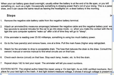

Sounds like there's a short circuit somewhere in the electrical system that's draining the battery overnite. Do a battery drain test.
https://images.2carpros.com/forum/automotive_pictures/12900_parastic_draw_1_63.jpg
