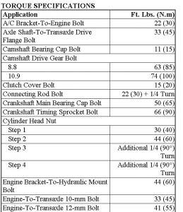

Hi
I need the tourque settings for the cylinder head
on a Vlokswagen. TRANS CARAVELLE GL D A
1993 MODEL ( K)
2370 CC
DIESEL

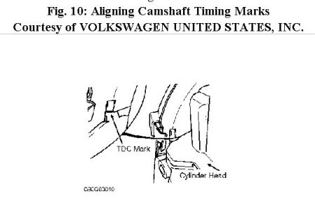

also I need the timing settings for the cam belt on the same engine.
thank you ;)

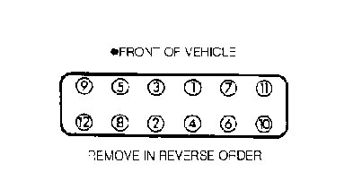

Well I came up goose eggs on the caravelle, but my suspicion may be the eurovan is the same thing. I found specs on a 2369 cc motor. IT gives the same on the 2.5 motor as well.
https://images.2carpros.com/forum/automotive_pictures/30961_vol1_1.jpg
https://images.2carpros.com/forum/automotive_pictures/30961_vol2_1.jpg
https://images.2carpros.com/forum/automotive_pictures/30961_vol3_1.jpg

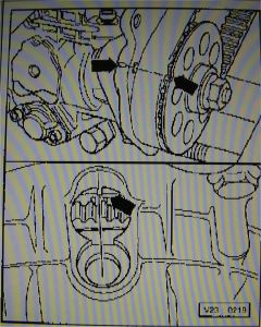

Anytime Chris, as you have for me so many times! One pic I couldn't get up right away from a different source:
https://images.2carpros.com/forum/automotive_pictures/30961_vw_1.jpg
