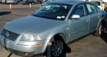

p.s., Inserted pic is similar to our car. Thanks again!
