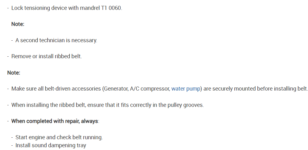

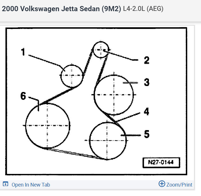

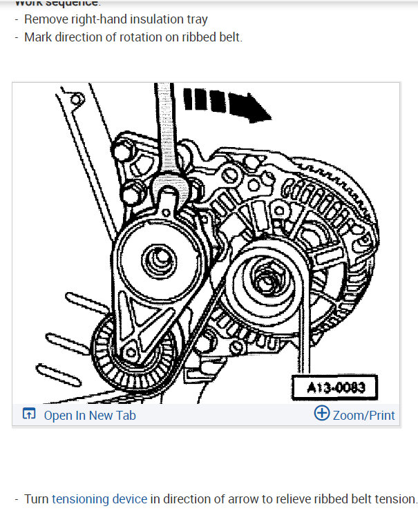

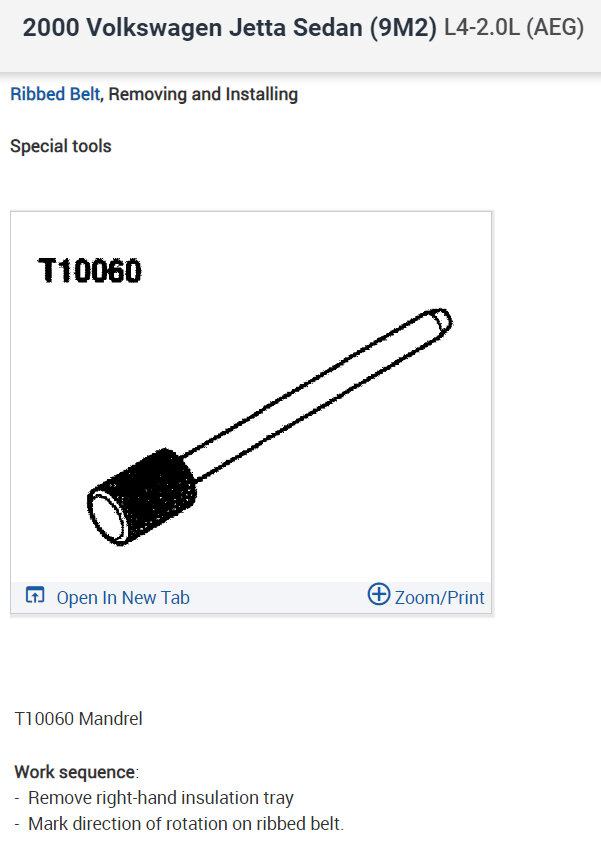

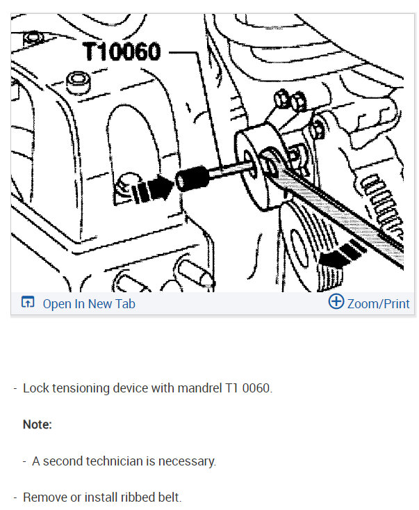

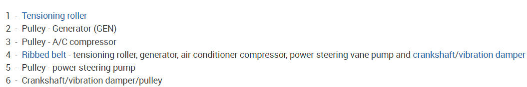

For the squealing at startup the belt orr belt tensioner is going bad, for the AC problem please start a new thread. Here is how to change the belt out which at this time check the tension of the belt tensioner. Check out the images (below). Please let us know what happens.
