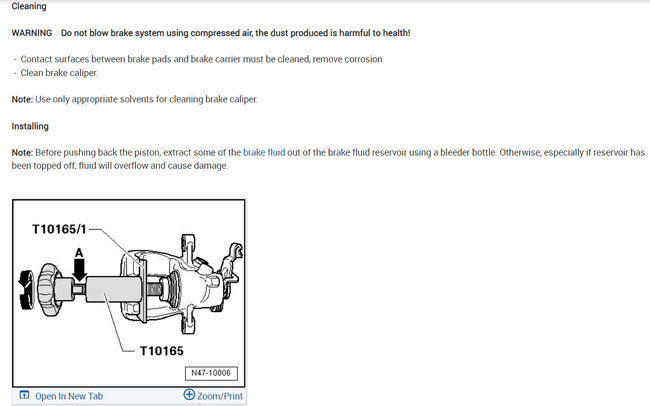

NO!
Use the tool to turn the piston back in, go slow, and keep the dust boot from twisting with it!

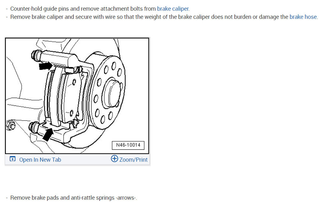

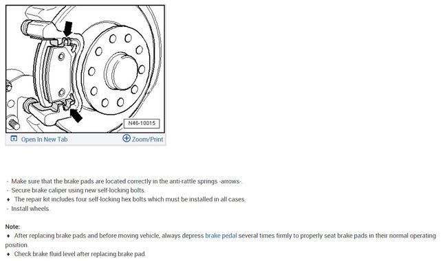

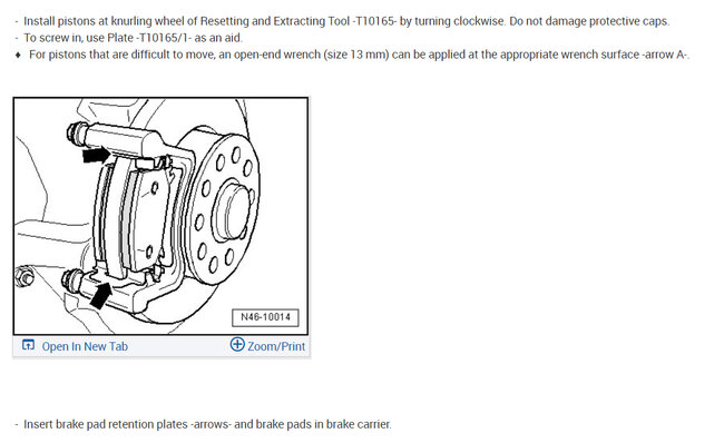

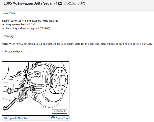

Simply wind the rear brake caliper piston inwards, here is a guide to help you and I have included the instructions for ou car in the images below.
https://www.2carpros.com/articles/how-to-reset-rear-brake-calipers-with-parking-brakes
Check out the images (below). Let us know if you need anything else.
