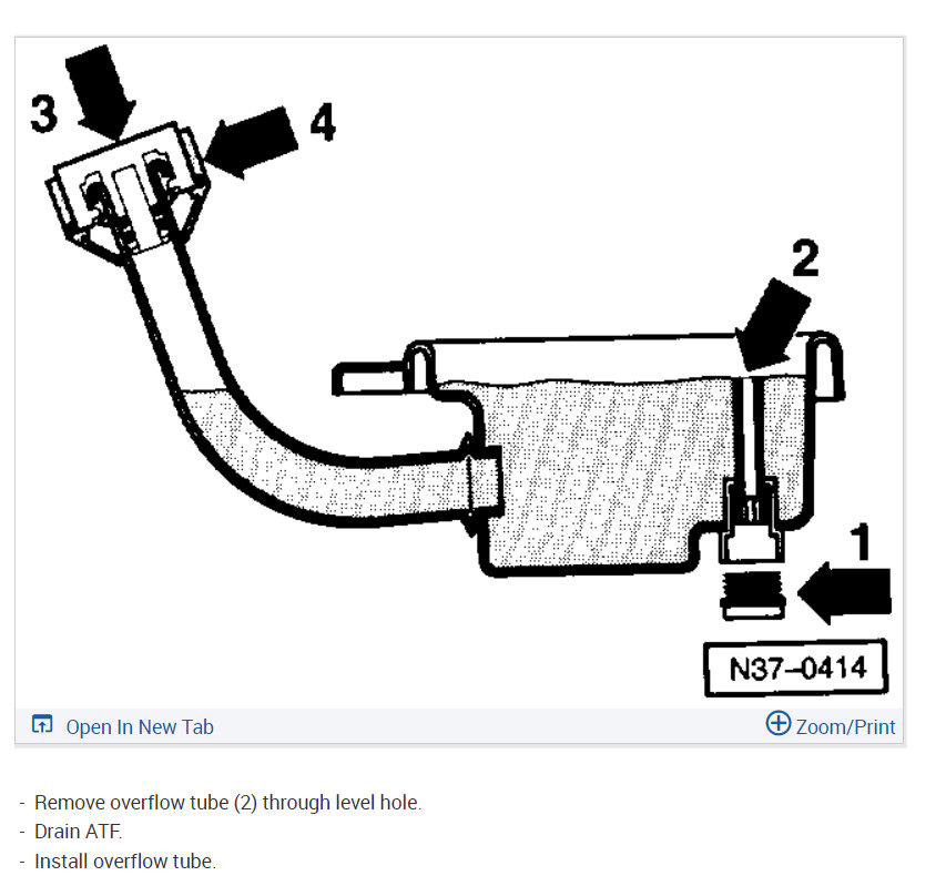

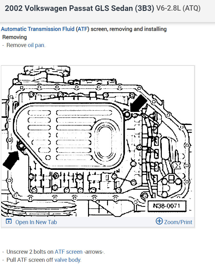

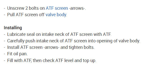

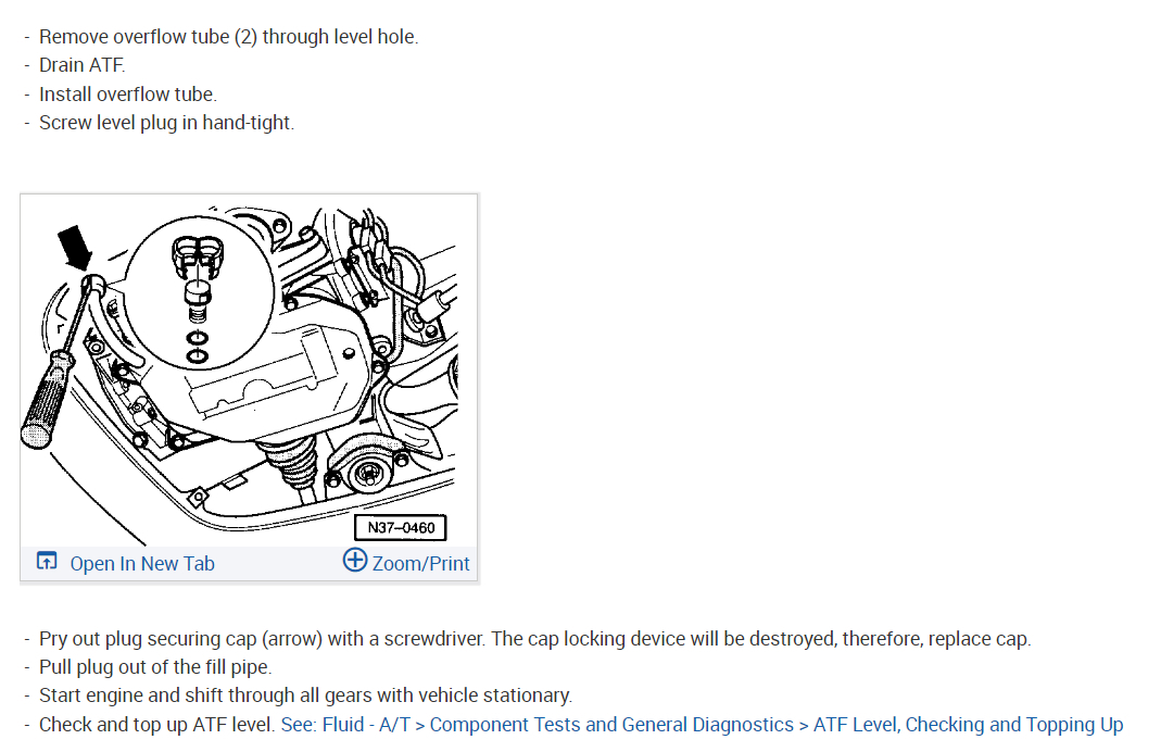

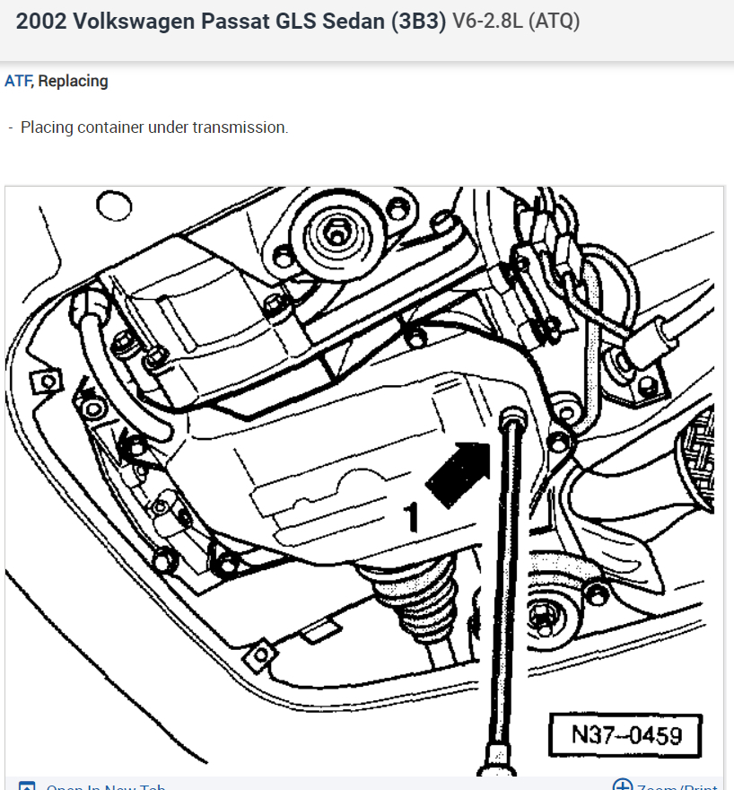

Yep, the more you service the transmission the longer it will last. Here is a guide that can help and I have included how to service your transmission i the images below.
Capacities
Planetary gearbox
Type .................... VW ATF
CAUTION:Always check with your parts department for the latest part number information.
Note:Only VW ATF available as a replacement part, can be used in the 01V transmission.
Final drive
Type .................... Gear oil SAE 75W90 (synthetic oil)
