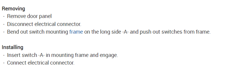

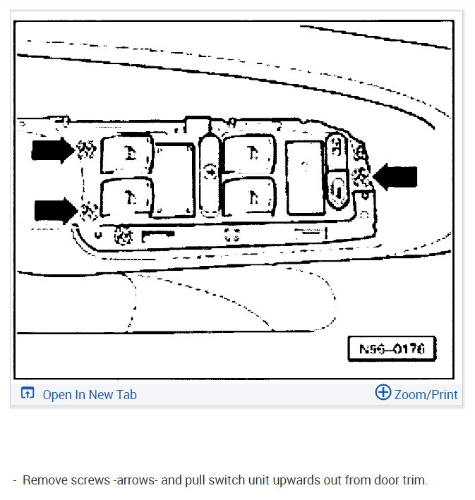

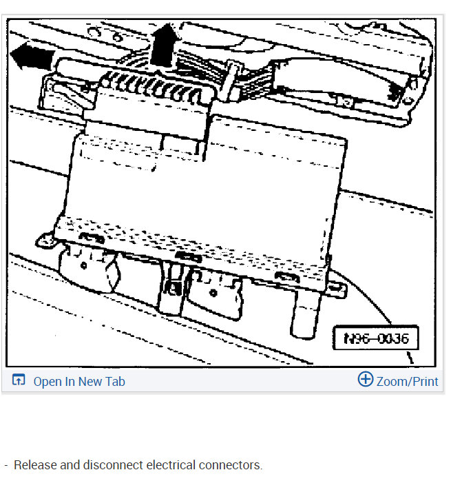

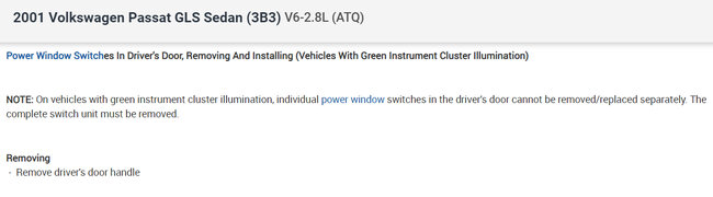

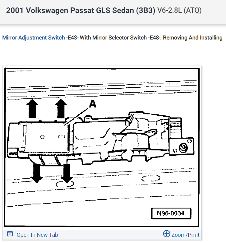

How do I replace the power mirror switch on a 2001 late model passat?
Is there an easy way to remove the front driver's side door panel?
Dec 9, 2007 at 2:44 PM
2CARPRO JACK
  • 11,533 POSTS
Looks like you remove the door panel and bend the tabs over and push the switch out
Dec 10, 2007 at 2:36 PM
  • 54,840 POSTS
This switch is inside of the window switch, here is how to change it out. Check out the images (below). Please let us know what happens.
