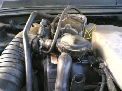

That will be good. I will locate the EGR in the mean time and give it a cleaning. I appreciate your help. Is this the EGR? (Sorry, my Haynes manual is practically worthless and the diagram in the engine compartment neglects to mention the EGR in the diagram).
https://images.2carpros.com/forum/automotive_pictures/70282_egrvalve_1.jpg
https://images.2carpros.com/forum/automotive_pictures/70282_diagram_1.jpg

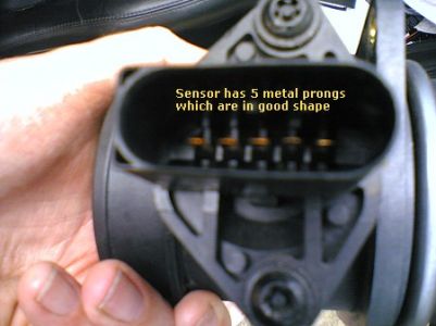

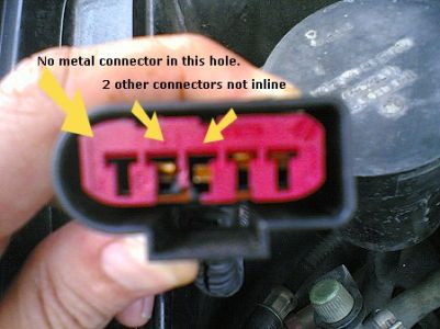

Interesting that you say that. I did check the connector yesterday and found a potential problem.
https://images.2carpros.com/forum/automotive_pictures/70282_connector2_1.jpg
https://images.2carpros.com/forum/automotive_pictures/70282_connector1_1.jpg

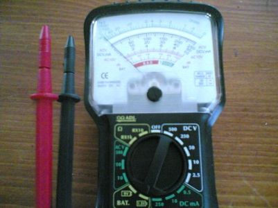

So, that concerns me, but I have no idea if the connector is supposed to have 5 metal pieces or 4 with a dummy hole. However, the sensor male plug does have 5 prongs. As for testing the connection from the PCM to the plug, I have an electrical tester, but have no idea how to use it to test this.
https://images.2carpros.com/forum/automotive_pictures/70282_actron_1.jpg

Check if there are 4 or 5 wires behind the connector.
Some do have dummy points.
If any connector pin is not aligned or is contaminated, it could be having a high resistance thus the wrong reading.
Clean and blow dry it with a contact cleaner or rust remover.

There are 4 wires behind the connector. The female connectors, two of them are loose and seem out of place a bit. I am not sure if that is creating a problem. I was thinking about finding some dummy wire to plug into each of the connectors individually, and all at once to test the MAF sensor with. In other words, instead of plugging the connector in to the MAF sensor, jump 4 wires from the connector to the MAF sensor. I will also give the cleaning a try.

Any loose connections can result in high or low resistance thereby sending the wrong signal to the ECM.
The MAF is a sensitive item and any slight changes would affect the ECM.
Try to tighten the female clips by compressing the clip area to make them tighter.
After plugging in connector, use a pointed object to push the female clips from behind the connector to tighten them.

Well, I can report some progress. I took the red part of the female connector apart and straightened the metal female prongs. They were bent and after I straightened them, and plugged the connector back to the sensor, the PO102 error did not come back. But, the engine continued to exhibit the same symptoms.

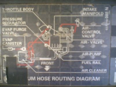

Thanks for sticking with me on this KHlow. I decided to check the codes again today before doing anything. I idled the car and tested the car at 2000 rpms... the rough running still persists at 2000 RPM (engine shakes, bogs down, wants to stall). Checked the codes and did not get a PO134 code immediately. Instead, I got a PO301 error (misfire cylinder 1). I let the car cool down. Came back and checked the codes and the PO301 was the only one there. I cleared the code and cranked the car and let it idle. I pushed the idle up to 2000 rpms and the shaking was still there. I got a PO301 again... cylinder 1. I decided to check the plug wire for #1. Popped off the end, did a visual, and then plugged it back on. Interestingly, the car idled perfectly up to about 3500 rpms after I did this. I decided to drive it. I took it up to about 3000 rpms on a couple of stop and gos... and everything seemed fine. I thought... the darn plug wire wasn't on tight. But then, on my way back to my house, the rough running happened again, only this time it seemed to happen at a lower rpm... about 1500. Got back to the house... checked the codes and got a PO301 error again. So, I decided to let the car cool and then I changed the #1 spark plug. The old one was fouled. I thought... AHA! But, no, after I cranked it, I got a PO302 code (Cylinder 2). What the???? It migrated to cyl 2? I let the car run for a bit, and it ran rough at almost any speed now. I checked the codes after a few minutes and got these codes.... PO300 (Multiple mis-fires detected) PO301 (cyl 1) PO302 (cyl 2) Later, the PO134 code came back into the picture. So, now I am a bit frustrated. I corrected the original problem with the MAF sensor (Code PO102) and that code has not come back. But since then, I have multiple misfires. In light of this new info, I decided to change out the remaining 3 spark plugs tomorrow. Do you think that this new info still indicates a bad 02 sensor like the code says, or does this sound electrical in nature? For the record, I replaced the coil on this monster of an automobile back in April. These 2000 Cabrios seem to have a problem with the coils and the aftermarket coils are not all that dependable. I appreciate any advice you can give me on this. I'm considering buying plug wires. Could it be the distributor cap? I guess what I'm saying is, maybe I should replace the plug wires and dist. cap tomorrow along with the spark plugs. Of course, if it is likely that the O2 sensor would create multiple mis-fires and the other symptoms I have described, then maybe I should replace the 02 sensor first. What do you think? As for the EGR valve... where would it be according to this diagram. VW doesn't use the EGR terminology...
https://images.2carpros.com/forum/automotive_pictures/70282_diagram_2.jpg

You are correct, the diagram does not show an EGR.
The problem did change when you replaced 1 spark plug, so I would suggest replacing the others and see if it improves.
