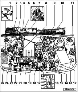

where is the engine computer on a 2000 vw cabrio

Hello It is number 5 in the pic Motronic Engine Control Module (ECM) -J220-*
