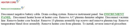

My car is spitting out coolant from the reservoir. The temperature gauge is not showing the car running hot. I just happened to notice the steam. I put more coolant in the car but it does not leak out from the bottom or anywhere that I notice... even took it to a shop and they are saying the same thing. (they normally dont work on volkswagens) It only bubbles and comes out the reservoir....
Can someone please help?
Thanks :oops: :oops:

This is a 7.0 hour job for a pro book time. I have no diagrams unfortunately.
