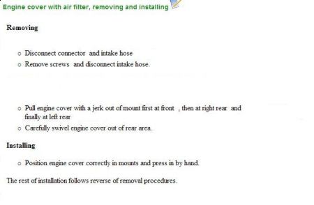

Where is the air filter on this car and how do I change it? I have the 5 cylinder, 2.5 liter engine. They make a filter, I purchased it and can't find where it goes. Any help is greatly appreciated.

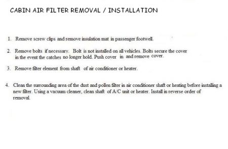

I'm interested in the location of and how to access the engine air filter. Since you mention the cabin air filter, it would be helpful to know where that one is too.

https://images.2carpros.com/forum/automotive_pictures/261618_Noname_929.jpg
https://images.2carpros.com/forum/automotive_pictures/261618_Noname2_249.jpg
