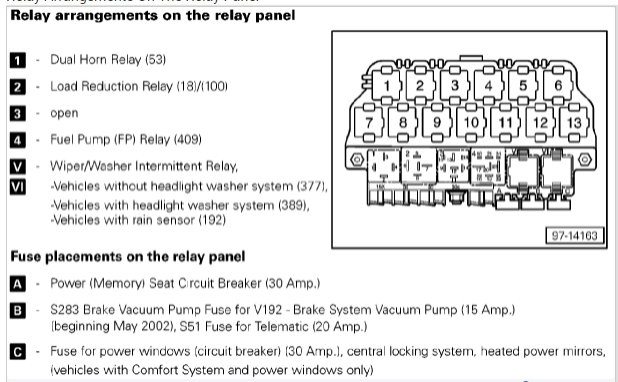

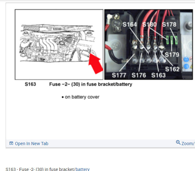

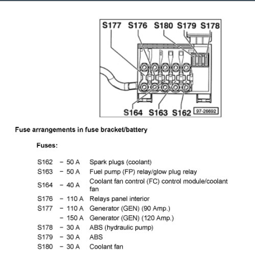

I have a 2005 TDI Jetta and have maintained it regularly. On Friday - it stopped - just stopped dead. So I had it towed to the house and I want to check the fuses can you help?
Mar 14, 2010 at 10:22 AM
DANNY L
  • 5,648 POSTS
Hello, I'm Danny.

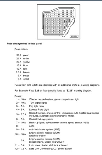

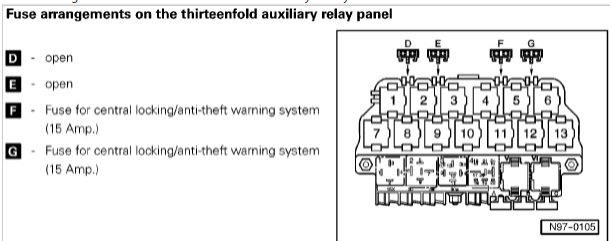

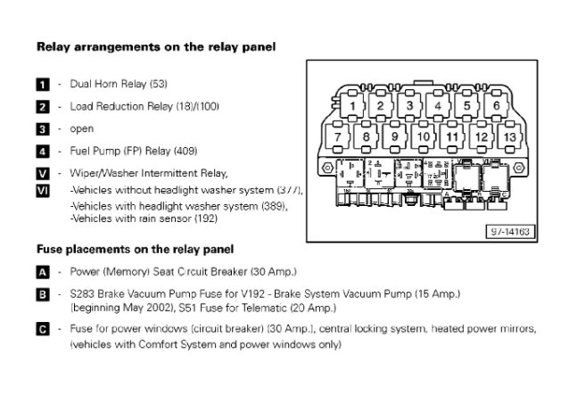

Here is the information you requested. Here are a few tutorials for you to view on how to check and replace fuses:
I've attached pictures below showing the fuse and relay locations on your vehicle. Hope this helps and thanks for using 2CarPros.
