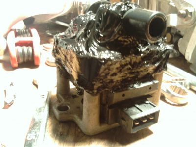

I have an 03 Jetta that when its wet and moist out it runs extremely rough and sometimes won't start. But when it is dry out it is quiet, nice, and runs how its suupose to. The battery also drains when left hooked up unless its nice out as well. In need of some help asap because as of now I have no vehicle. The motor and tranny are all good and replaced though and the coil pack is also good I was told. I was told it would have to be electrical ground wiring somewhere needs replaced but don't know. PLEASE HELP

Well I have a 97 jetta doing the exact same thing and after checking everything very throughly I found it to actually be the ignition coil having a hairline crack in it. And as for fixing it I covered the coil in silicone making sure to keep it away from all connections and just doing the housing. Now the car starts everytime and runs perfect even when its pouring rain. I hope this helps
https://images.2carpros.com/forum/automotive_pictures/527552_temp_2.jpg
