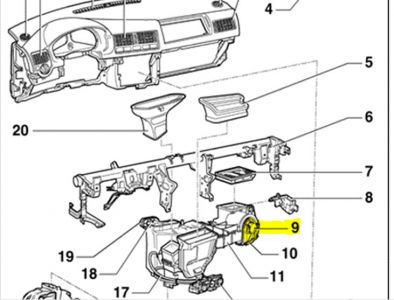

2002 Volkswagen Jetta Blower fan replacement
2002 VOLKSWAGEN JETTA
KERY92664
Heater problem
2002 Volkswagen Jetta 4 cyl Two Wheel Drive Manual
Specific procedures on how to replace blower fan motor, resistor and regulator
Sep 27, 2010 at 3:30 AM
BMRFIXIT
  • 19,053 POSTS
https://images.2carpros.com/forum/automotive_pictures/99387_jett_1.jpg

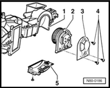

Fresh Air Blower V2 , removing and installing Courtesy of VOLKSWAGEN UNITED STATES, INC. Removing 1 - Heating and ventilation (or heating and A/C unit where applicable) 2 - Fresh Air Blower V2 3 - Cover 4 - Screws 5 - Fresh Air Blower Series Resistor With Fuse N24
https://images.2carpros.com/forum/automotive_pictures/99387_jet_1.jpg
Remove glove compartment. Disconnect electrical connection for N24. Disconnect electrical connection for V2. Remove resistor for fresh air blower. Remove fresh air blower downward. Installing Install in reverse order of removal.
